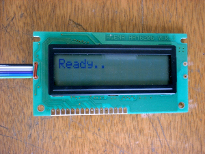

initializing the LCD screen
The LCD display ready for action
